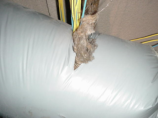

Check these out! These are Cat "5" cables that were recently installed.
The cable technicians (if you want to call them that) proceeded to saw
through the ductwork when installing their cables. We found these problems
after receiving complaints from associates that occupied the offices that
this ductwork served. I guess that these cables really have to be plenum
rated.
I thought you would like to see a cabling standards violation.
